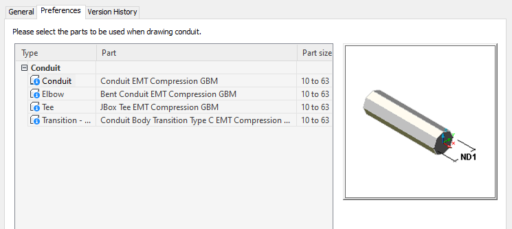

A conduit part routing preference includes one or more connection types (such as set screw) in the available part sizes for conduits and fittings. A preview of the selected part displays to the right of the dialog box. The image to the right provides a graphical representation of the selected part.
