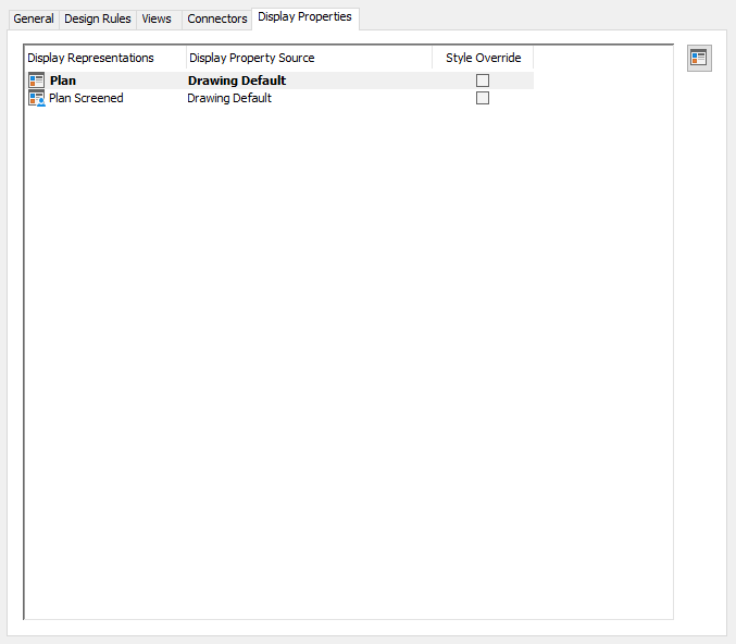

- In the Styles dialog box, click the Display Properties tab.
- Configure the display properties:
If you want to… then… change the display of an object style’s components, such as visibility, layer, or color select the display representation, click Style Override, and edit the component display properties. reset the display representation to the drawing default click Style Override to clear the override. change style-specific display settings select the display representation, click Edit Display Properties, and then click the Other tab to make changes. The Other tab is displayed only in some display representations. - Click OK twice.
