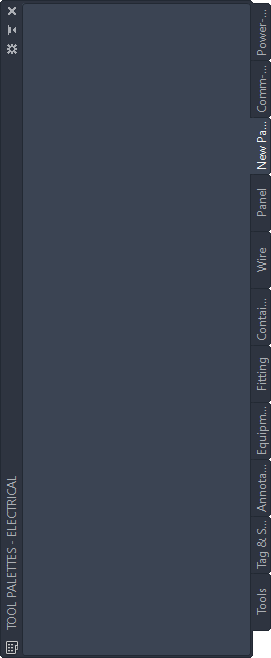

If you want to… then… modify the set of tool palettes for the current profile click Browse or Add to change or add tool palettes (ATC files). If desired, you can create copies of the tool palettes provided with the software, modify the copies, and then specify the file locations for the copies. create an empty tool palette set specify the file location of an empty folder. Once you click OK in the next step, this results in a blank tool palette set, to which you can add palettes and tools. For more information, see Creating a Tool Palette and Customizing Tools.
Empty tool palette set
- Rename the tool palette set.
