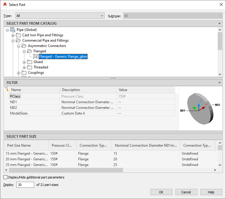

- On the Properties palette, under General, click the part image.
- In the Select a Part dialog box, choose a part from the catalog.
Under Select Part from Catalog, the dialog box organizes pipe parts based on material type in the US Imperial and US Metric profiles. For more information, see Pipe Parts Catalog.
- Select Display/Hide additional parameters to expand the contents of the parameters table.
- Under Filter by Dimensions, filter the list of parts. Note: The part catalogs and content locations determine the parts that you can add.
- Select a part size and click OK.
