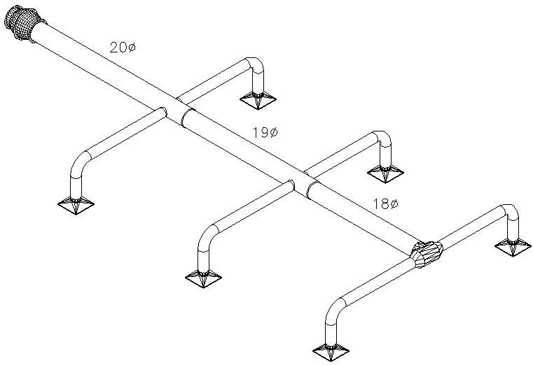

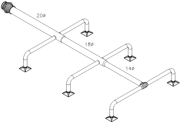

The following illustrations show a system design before and after sizing.
Preliminary system design before resizing
Optimized system after resizing
