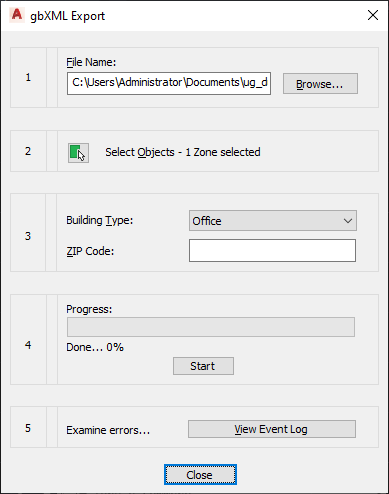

  4. In the Export to gbXML dialog box, specify the export settings:
    • File name: Specify a file name and location.
    • Select Objects: The dialog box automatically detects all zones in the current drawing. Zones in reference drawings cannot be exported unless they are attached to a zone in the current drawing. If the dialog box does not detect all zones, click Select Objects and select the desired zones.
    • Building Type: Specify a building type and postal ZIP code that may be used by the external analysis program.
    • Progress: Click Start to run the export.
    • Success: If any errors occur during export, the event log opens to allow you to view error messages. You can view the event log at any time by clicking View Event Log.
