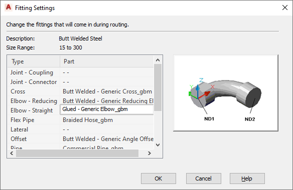

  2. On the Properties palette, expand Advanced, and under Routing Options, click to open the Fittings Settings dialog.
    Fitting Settings dialog
    The Fitting Settings worksheet shows the current description and size range from the catalog, and lists the available types and parts. If no value is available, the worksheet shows “- -”.
  3. In the Fitting Settings dialog, select the fitting type to override.
  4. Choose a part from the list.
  5. Specify points to lay out the pipe run.
    The overridden part is automatically inserted into the layout.
