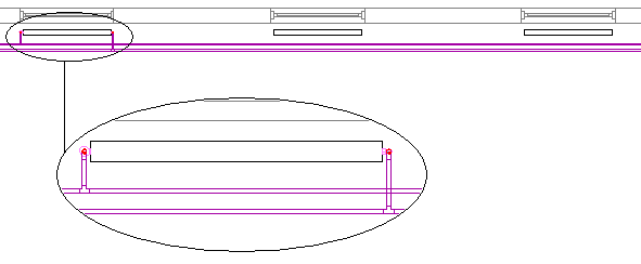

  1. Add valves to the connectors on a radiator (the source radiator) and create branch pipes that connect the radiator to a set of parallel supply and return pipes.
  2. Select the source radiator.
  3. Right-click, and click Connect Multiple Parts.
  4. Select one or more target radiators, and press Enter.
