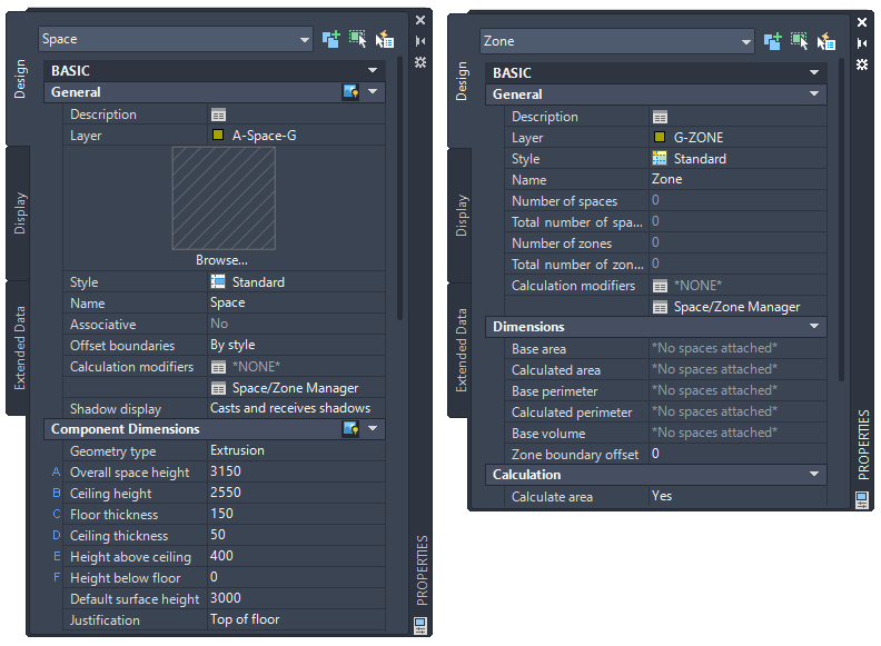

- To view calculations, click a space or zone, and click the Extended Data tab on the Properties palette.
The calculation results are displayed under SpaceEngineeringCalculatedData for spaces, and ZoneEngineeringCalculatedData for zones.
