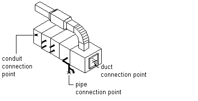

  2. To add points on your model to help locate connectors, enter point, press Enter and, using object snaps, select the center of a connector on the 3D model.
    Add AutoCAD point objects in the location of the center of all connections. This lets you use Node object snaps to select the connection points when assigning connectors.
