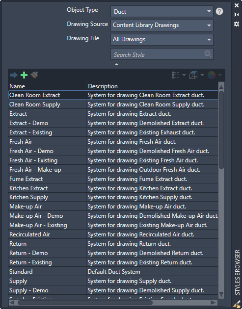

Apply a System Using the Properties palette
  1. Select an AutoCAD MEP 2025 toolset object.
  2. In the Properties palette, click Advanced System System
  3. In the Styles Browser palette that displays, select Content Library Drawings in the Drawing Source drop-down.
  4. Select the Drawing File from the drop-down.
  5. Select a system from the list displayed in the gallery.
Search for Systems Using the Styles Browser palette
  1. In the Styles Browser palette, select Content Library Drawings in the Drawing Source drop-down.
  2. In the Search Style, enter a string of characters from the content drawing file name.
  3. Select from the search results displayed in the gallery.
