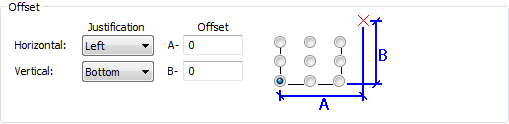

  2. In the Cable Tray Layout Preferences dialog box on the Routing tab, under Offset, specify the alignment for cable tray insertion:
    If you want to… Then…
    align the centerlines of the cable trays along the points you specify for the run under Justification, select Center for Horizontal and for Vertical. Enter 0 for Offset A and for Offset B.
    align one or 2 sides of the cable trays along the points you specify for the run under Justification, select Left or Right for Horizontal, and/or select Top or Bottom for Vertical.
    offset the cable trays from the points you specify for the run enter a distance for Offset A and/or for Offset B.
    To assist you, the preview image on the right provides an example of the current selections.
