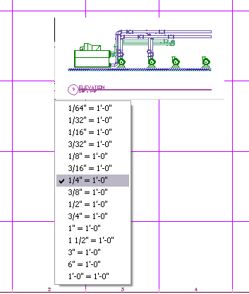

  9. Drag the view drawing onto the sheet.
    If you want to change the size of the view on the sheet, right-click and select a new scale.
