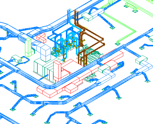

3D detail view of a mechanical room

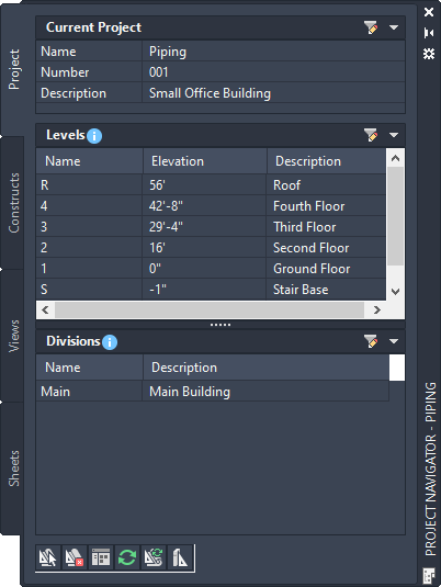

Project Browser
Project Browser creates projects and specify high-level project information and settings, such as the project number, project name, contact information, and the file locations of the drawing templates, tool palettes, and the project-specific Content Browser library to use.
Project Navigator
Project Navigator centralizes project-specific tasks, such as defining building levels and divisions (wings), creating project drawings, and creating plotting sheets.
