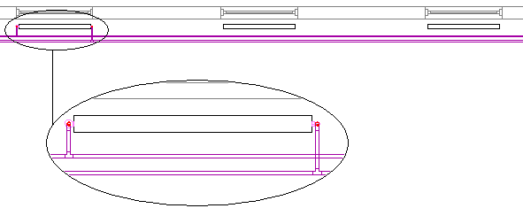

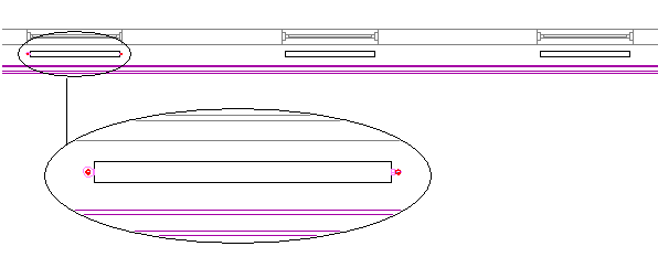

After you have placed the radiators in your drawing, use this procedure to create the parallel pipework for a radiator system.
  1. Add the parallel pipes for the radiator supply and return. See Adding Parallel Pipes to a Radiant Heating System.
  2. Add valves to the connectors on a typical radiator. See Adding Radiator Valves.
  3. Add branch pipes to connect the valves to the supply and return pipes. See Connecting to Existing Pipe and Connecting a Pipe Run to an MvPart.
  4. Copy the valves and branch pipe layout to similar radiators to connect them to parallel pipes. See Connecting Multiple Radiators.
