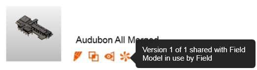

After you share a model with BIM 360 Field, a notification appears in Latest Model Activities on the Dashboard. It indicates which version of the model is shared and whether Field is using the model. An orange icon indicates that Field is using the model. The notification includes version details. If the model isn't in use, the icon is dimmed.
