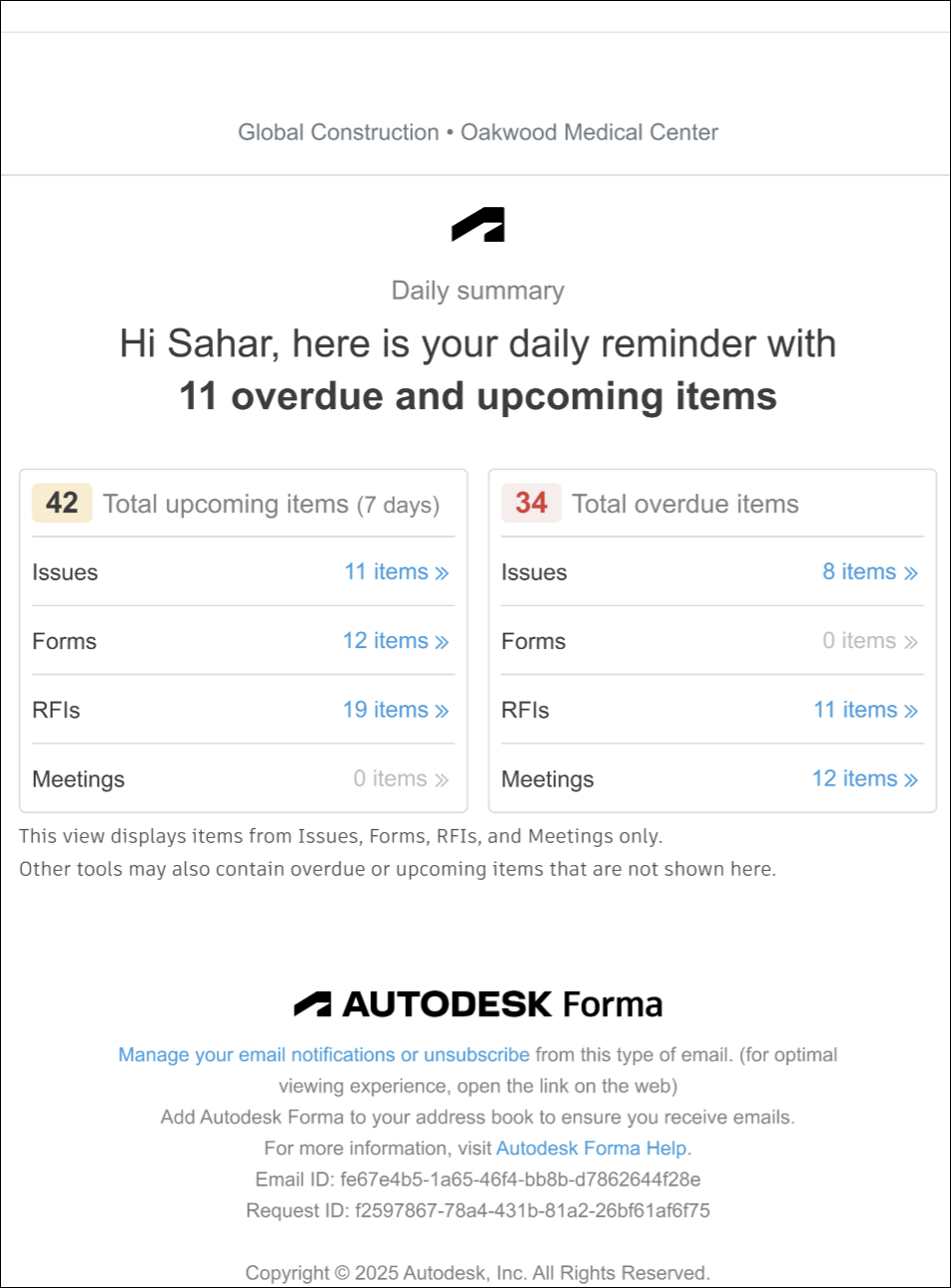

Daily digest emails are sent at 4:00 AM in the time zone specified for the project profile. When a daily digest is generated, it includes a personalized introduction with the member's name and a total count of all items included in the email (upcoming items, overdue items, action required items, and update items).
The daily digest is organized into the following sections:
Due Date Reminders
Note the following about due date reminders:

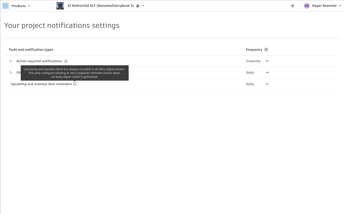

  • Due date reminders are sent daily when there are assigned upcoming items due within the next 7 days or assigned overdue items from the previous 30 days.
  • Items are included when they are assigned directly to the member or to the member's company.
  • When a daily digest is generated, due date reminders are sent as part of the digest and appear as summary tables at the top of the email. When no daily digest is generated that day, due date reminders are sent in a separate email.
  • Separate due date reminder emails can be turned off in notification settings by adjusting the Upcoming and overdue item reminders setting.
  • Due date reminders include two summary tables:
    • Total Upcoming Items: Displays items due from the current date through the next 7 days. Clicking the link for a specific tool applies a filter showing items due within this timeframe.
    • Total Overdue Items: Displays all overdue items. Clicking the link for a specific tool applies a filter showing all overdue items.
