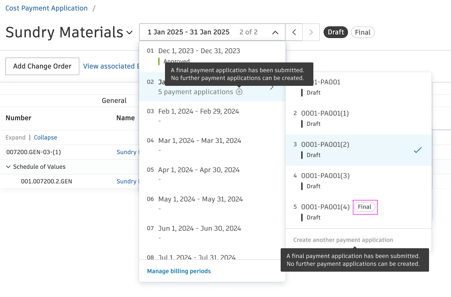

  4. Toggle the switch for Set as the final payment application.
    Toggle switch to set payment application as final
Application is now set as final and new cost payment applications can't be created.
Tooltips show when application is marked as final
Marking a payment application as final will trigger the release of all retained funds associated with the contract. Ensure that all work is completed and inspected before setting the payment application as final.
