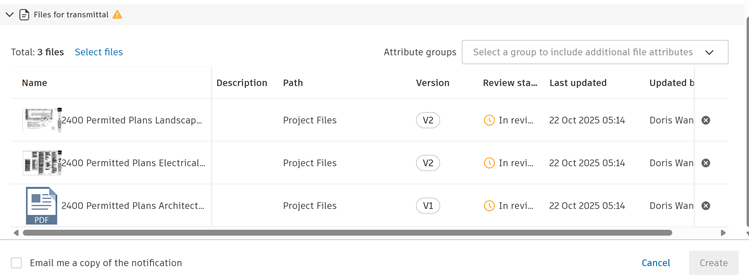

    • Files for transmittal
      Check the list of files included in the transmittal. Click Add files to add more files or click next to a file to remove the file from the list.
      Attribute groups: You can also add the attributes contained in an attribute group to the files in the transmittal. Select an existing transmittal group to preview and add the attributes. See Transmittals Settings for details on how project administrators can create attribute groups.
      Note: Attribute values are captured at transmittal creation time and don't change if updated later.
  5. Select Email me a copy of the notification if you want to receive an email to confirm that the transmittal is created and sent successfully.
  6. Click Create.
