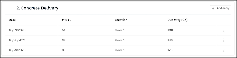

When you build a form template, you can create tables with custom column and the rows will populate with information from form fillers, such as text, dates, or drop-down selections.
Use a table to:
  • Capture detailed project information
  • Track time, resources, and work progress
  • Customize data collection to fit your needs
Table section in form template. Example of a table section in a form template.

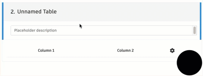

Add Table Sections to Form Templates
  1. Open a form template in the Forms tool.
  2. In the left panel, click the Plus icon. Plus icon for adding sections. icon and select Table.
    Note: You can add up to four table sections to a form template. The Equipment, Work Log, and Materials sections count as table sections. For example, if you have one of these sections, you can add up to three more Table sections.
    Add sections. Add sections panel in the Forms tool.
  3. Enter a name for the table section.
  4. Enter a value from one to 15 for the number of columns that you want in the table.
    Note: You can add or delete columns later. You must have at least one column to start.
  5. Click Next.
  6. Enter names for each column. Click the trash icon Trash icon. Trash icon for deleting columns. to delete a column.
    Note: Column names must be unique and 50 characters or fewer.
  7. Click Create.

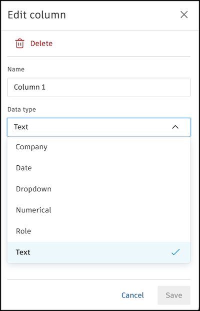

Edit a single table column in a form template
  1. Click a column header.
  2. In the panel that appears, you can:
    Configure table column
    • Click Delete button. Button for deleting a column. to delete the column.
    • Edit the column name.
    • Select the data type for the column. Choose from:
      • Company: Form fillers select a company from the project's account.
      • Date
      • Dropdown:
        1. Enter the options for the drop-down.
        2. Click Add another option to add more options.
        3. Click the trash icon Trash icon. Trash icon for deleting options. to delete an option.
        (Optional) Turn on Allow free-form text responses to let form fillers enter their own value instead of selecting from the drop-down.
        Note: You can add up to 100 options in a drop-down column. Each option must be 50 characters or fewer.
      • Numerical: Form fillers can enter whole numbers or decimals. If they enter decimals, the value rounds to two decimal places. The value must be positive.
      • Role: Form fillers select a role from the project's account.
      • Text: Form fillers can enter up to 200 characters.
  3. Click Save.

Edit Table Section Name and Description
To edit the table section name after you add it to the form template:
  1. Click the section title.
  2. Type a new name for the table section.
  3. Click away to save.
  4. (Optional) Add a description for the table section in the Placeholder description field.
You can also add a description for the table section in the Placeholder description field.
Edit table section name and description
