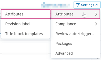

Project-Level File Attributes
Project administrators can manage system, custom, and naming standard attributes at a project-level using attributes settings:
  1. Click the Files tool.
  2. Click Settings.
  3. Click Attributes.

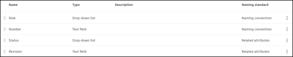

Attributes Settings
The Attributes tab lists all the attributes in the project.
The different types of attributes listed can be categorized as:
  • System attributes: These are the default system attributes which are added to every project. System attributes can't be edited or deleted.
  • Custom attributes: These are attributes created for the project by members with Edit permission or above.
  • Naming standard attributes: These are attributes which are part of the naming standard. The Naming standard column shows shows which naming standards attribute is added to.
    See Edit Naming Standards for more information on naming standard attributes.

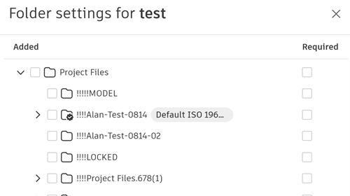

Custom Attributes Folder Settings
You can add or remove most custom attributes to or from any folder.
Important: Once naming convention attributes or related attributes are added to any folder, they can't be removed.
Note: You can add a maximum of 50 custom attributes to a folder.
  1. Click the More menu of the relevant attribute.
  2. Click Folder settings.
    If the attribute is already added to folders, those folders will be already selected.
  3. Add or remove the attribute as required by selecting or deselecting folders.
  4. Click Save.
