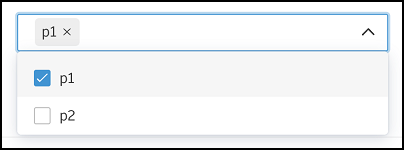

Sheet Tags
While disciplines are automatically assigned to sheets after publication, tags allow us to further group and find sheets quickly from the field.
Edit Tags for Individual Sheets
You can manually select or remove tags from the drop-down list in the Tags field for each sheet.
Edit Tags in Bulk
Select the sheets whose tags that you want to add or remove.
  1. Click Edit tags.
  2. Add and remove tags as required.
  3. Click Apply to selected sheets.
