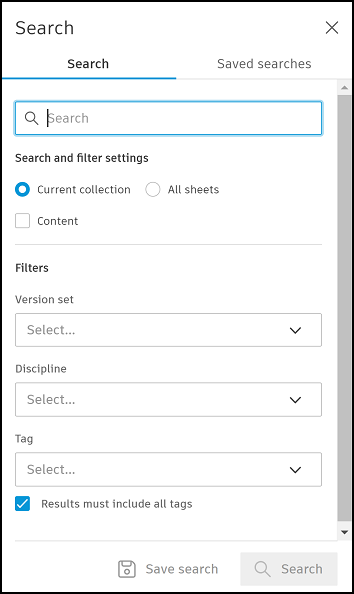

  2. Click Search and filter.
    This opens the Search panel which defaults to the Search tab. See Saved Searches for information on the Saved searches tab.
  3. Enter your search terms.
    Note: Your most recent 5 searches are available when you click in the search box.
  4. If your project has collections enabled, there are extra options to search the Current collection or All sheets in the project.
  5. Select Content if you want to search the content of sheets for the search terms. This will also enable the use of the following operators for searching content, sheet numbers, and titles.

  1. Select one or more of the following filters if required:
    • Version set
    • Discipline
    • Tags: Select Results must include all tags if you want the results to include all of the selected tags.
    Note: Click Clear all to clear your search terms, filters, and search results if you've already run a search.
    You can click Save search to add this search to the Private section of your Saved searches tab. See Saved Searches in Sheets for more details.
  2. Click Search.
