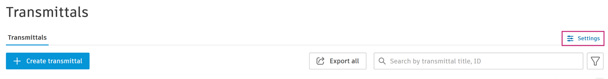

Access Transmittal Settings
  1. Click the Transmittal tool.
  2. Click Settings.

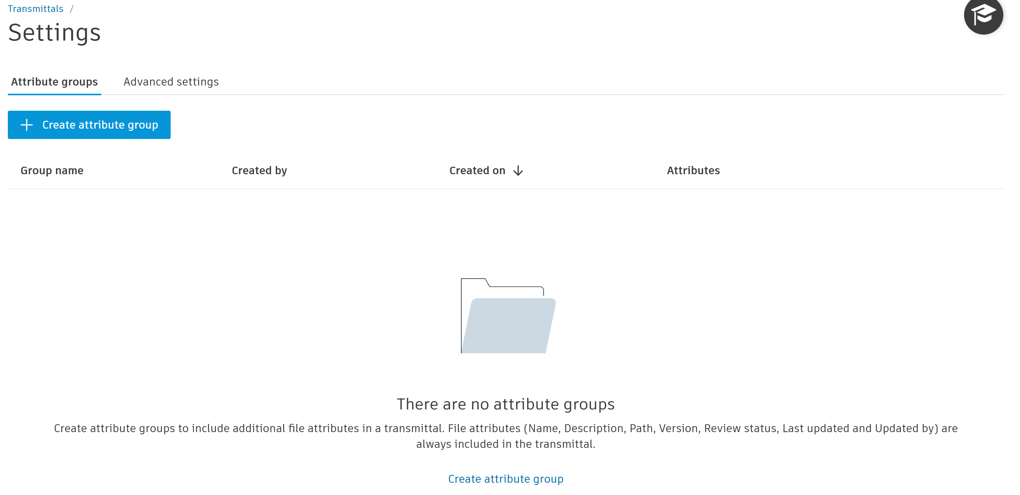

How to Create an Attribute Group
  1. Click Transmittals
  2. Click Settings
  3. Click Attribute groups
    No attribute groups will be listed if there aren't any created yet.

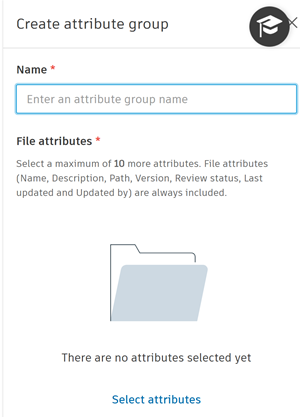

  4. Click Create attribute group
    This opens the Create attribute group panel.
  5. Name: Enter a unique name for your attribute group
  6. File attributes: Click Select attributes and choose a maximum of 10 system and custom attributes in the select attribute dialog.
  7. Click Select.
  8. Review your selected attributes in the preview area
  9. Click Create.

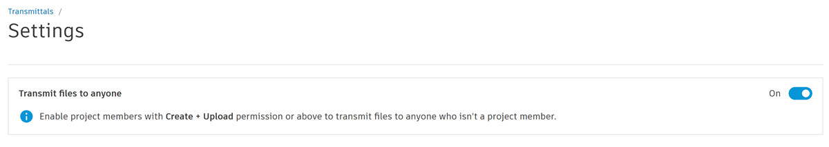

Advanced settings
Transmit files to anyone
By default, members can only create and send transmittals to other project members.
Project administrators can choose to allow project members with Create + Upload permission or above to also transmit files to anyone who isn't a project member.
Click the toggle to turn on Transmit files to anyone.
The option to send transmittals to non-members will now be available when members create transmittals.
