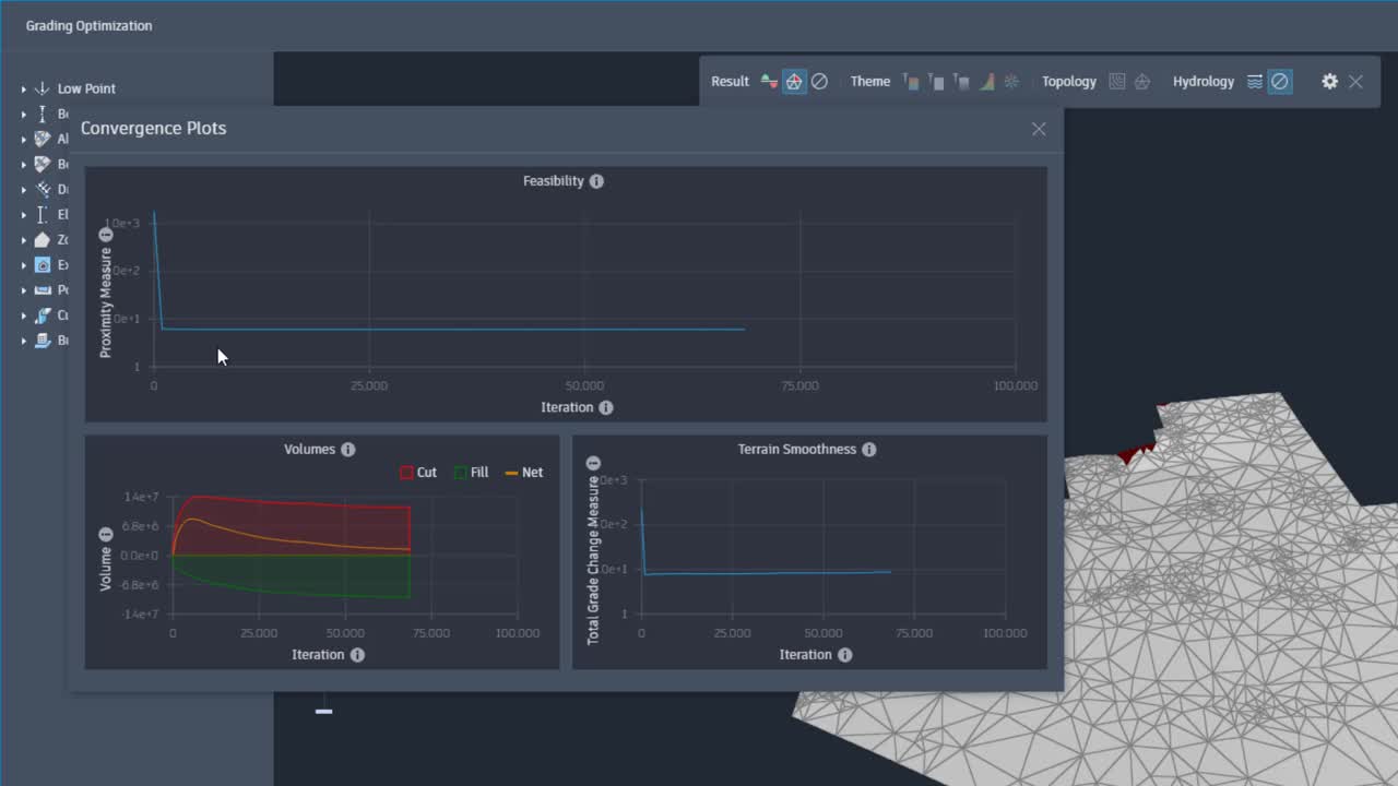

  • Feasibility assessment with the Convergence Plots dialog.
  • Using Violation View feedback.

The Convergence Plot is used to see the progression of optimization. Because full optimization can take time to process, it is useful to identify issues before optimization completes. The Proximity Measure may fluctuate with each iteration, but it should trend downward as it did early in this optimization example. Ultimately, it is trying to reach zero. If the Proximity Measure remains at a fixed value, this indicates an issue in which the desired constraints and objectives are not feasible.
Using the Violation View in the Visualization Toolbar, you can identify problematic surface triangles and see how they are failing to optimize.
In this example, the Maximum Slope Constraint is violated because the triangles are along the surface bordering the zone, which is fixed.
