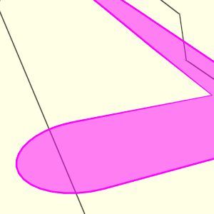

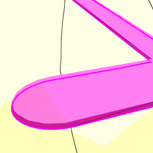

The Curb grading object will break the terrain along the curb geometry and step the terrain at a specified height and width. Closed geometry will step the curb up toward the inside of the geometry. Open geometry will step the curb up on one side, but the curb may need to be manually reversed.
As Configured Optimized
When selected:
one The higher side of the curb displays as a shaded line.
two The thin line represents the lower side of the curb.
curb highlights
This orientation can be reversed using the Reverse Curb property of the Curb Properties panel
