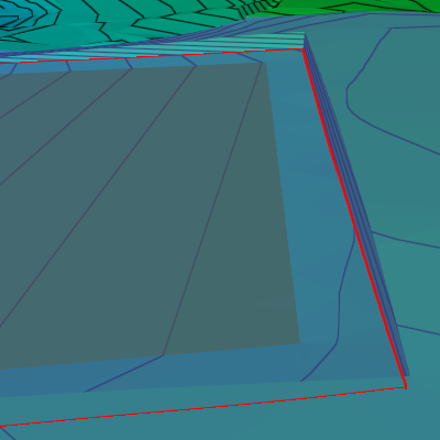

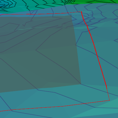

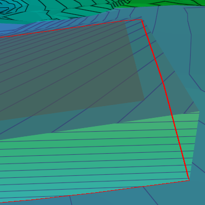

A retaining wall breaks the terrain along the wall linework and steps the terrain within the specified height constraints of the wall.
As Configured Optimized Reversed
When closed geometry is drawn in a clockwise direction, the terrain will step up along the outside of the geometry. If drawn in a counter-clockwise direction, the terrain will step up toward the inside of the geometry. Either method can be reversed from the Retaining Wall Properties panel.
When selected:
one The higher side of the retaining wall displays as a shaded line.
two The thin line represents the lower side of the retaining wall.
retaining wall highlights
This orientation can be reversed using the Reverse Curb property of the Retaining Wall Properties panel.
