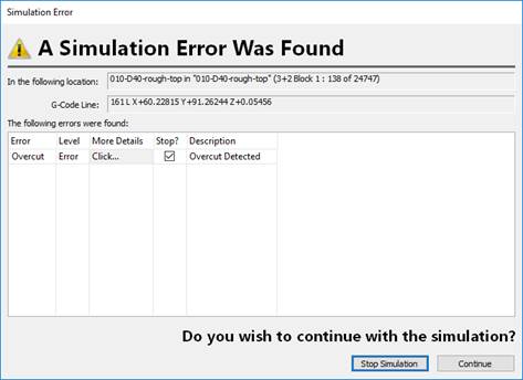

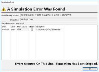

  8. If any collisions or errors are found, the simulation will pause and you will see the Simulation Error dialog.  If the error occurred during a very small move or when the machine was not moving, you will see this error dialog:
    Stop Simulation – Will stop the simulation immediately, since the error occurred at the end of the given NC code line.
    Continue – Will continue the simulation and any new errors will continue to be reported.

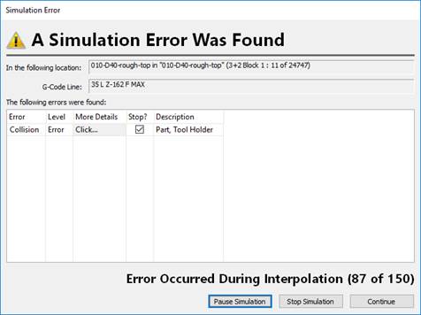

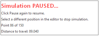

  9. If the error occurred during a long motion (with interpolated points) you will see this version of the dialog:
  10. The error dialog will state the error occurred during an interpolated move and also show the current point index in the interpolated motion.  At this point, you will see the collision highlighted in the 3D view exactly where it occurred, even through the entire move has not been completed:
  11. At this point, you can click Pause Simulation, Stop Simulation or Continue
    Pause Simulation – This option will pause the simulation at the interpolated point.  The rest of the move will not be completed until you press Pause again.  When Pause Simulation is used, you will see the “Simulation PAUSED” status window will appear in the upper right:
    At this point, the only way to complete the move is to click Pause again (Note that the Start, Stop and Rewind controls are no longer available:
    Stop Simulation – This will resume the simulation and stop when the current move has completed.  The error dialog will not appear again until the line is completed.  All further simulation errors will be shown at that point:
    Continue Simulation – This will resume the simulation.  For the remainder of the current block being executed, the error dialog will not appear until a different error is encountered.  (This “ignore” only stays active for the current NC code line being simulated)

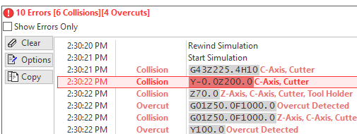

  1. The errors will also be shown in the Status window.  For example:
  2. Click the Expand button to show the individual errors.  Collisions and Overcuts (gouges) will be shown as errors.

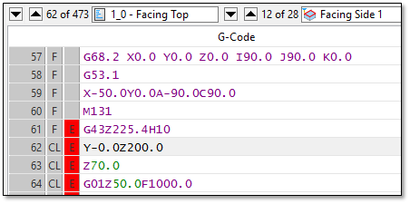

  3. To go to the line that caused the error, double click the entry in the Status view:
  4. That line will be highlighted in the Program Editor:
    Note: Any lines that are causing errors will appear with a red E in the editor.

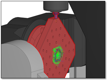

  5. The simulation will also show you where the machine was when the error occurred.  Any colliding parts will appear in red:

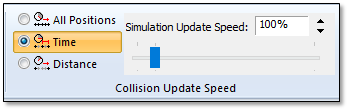

  5. The Collision Update Speed section controls the update timing:
    If the updating timing is set to slow, then simulation update will appear smoother and it will take longer to play back.  If the updating timing is set to fast, the update will be more jagged, but the simulation will be run faster.
    All Positions –Update the simulation for every position being checked.  This includes interpolated positions for longer moves.  This will be the slowest mode, but is useful when attempting to find problem areas in the program.
    Time – Update the simulation based on time.  This will update the view at a set time interval (controlled through the Options referred to below).  This is the fastest playback method but the update will appear very choppy.
    Distance – Update the simulation based on distance.  This will update the view based on how much the machine axes have moved.  This is a good compromise for playback speed and smoothness.
  6. In Time and Distance update modes, you can use the Slider Bar to control the update speed.  Set it to smaller value (to the left) to slow the simulation down and a larger value (to the right) to speed up the simulation.

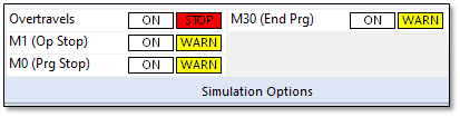

  7. The Simulation Options section controls the various items that will be checked during the simulation:
    Each item has a ON or OFF status.  ON means that the option is active.  To toggle the given option, click the ON/OFF button.  (Note that Collisions cannot be turned OFF)
    Each item also has an Error Handling button.  This can be set to WARN or STOP.  When it is set to WARN, if this error occurs it is logged as an error to the status view but the simulation is NOT stopped.  If it is set to STOP, then the simulation will be stopped if this error occurs.  To toggle this option, click the WARN/STOP button.
    Any items that require a tolerance (Proximity checking and Overcuts) will have a tolerance edit box to see and edit this value.  To edit the value, click the tolerance box and you can edit it.

    Overtravels
    Check for overtravel conditions.  Use ON to enable this option and STOP to stop the simulation if one is found.
    M1 (Op Stop)
    Use STOP to stop the simulation if an optional stop is encountered. (This option cannot be turned OFF)
    M0 (Prg Stop)
    Use STOP to stop the simulation if a program stop is encountered. (This option cannot be turned OFF)
    M30 (End Prg)
    Use STOP to stop the simulation if program end is encountered. (This option cannot be turned OFF)

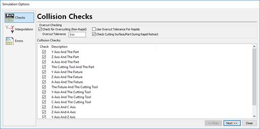

  1. The Checks page shows the current collision checks that are being performed:
    Overcut Checking options:
    Check for Overcutting (Non-rapid)  – This option does the same thing as the Overcuts option on the Simulation Options section.  You can adjust the overcut tolerance here, if you wish.
    Use Overcut Tolerance For Rapids – This option will use the current overcut tolerance when checking rapid moves.  This can be used to remove collisions that occur when the tool is touching the part in interpolation mode (G01) and switches to rapid (G0) while still touching the part.  Normally, TruePath would flag that as an error.  However, by enabling this option, it will only be flagged as a collision if the touch is gouging the part by the overcut tolerance amount or more.
    Check Cutting Surface/Part During Rapid Retract – This option does more detailed collision checking when the tool is retracting from the part to eliminate collision reported when rapid off of the part or when retracting from a pocket or drilled hole.
    Collision Checks – This grid lists the current collision checking pairs for the simulation.  You can disable specific checks if you are SURE that they will not collide.  For example, if the part is small, you can disable checks of the part and fixture against the tilting axis.  This can be used to speed up the collision checking process.  Use EXTREME CAUTION when making these changes.  If you are unsure, contact CAMplete Solutions for advice.

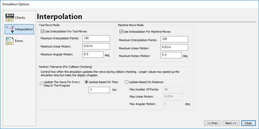

  2. The Interpolation page controls how TruePath simulates points in between the programmed positions:
  3. In general, you should not change anything in this dialog.  Contact CAMplete Solutions if you are interested in making changes to these settings.

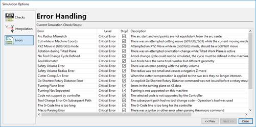

  4. The Errors page shows any critical errors that are checked during simulation:
  5. Normally, if any of the above errors are found during simulation you can un-check it’s Stop? column.  However, the errors will still be reported in the Status window.

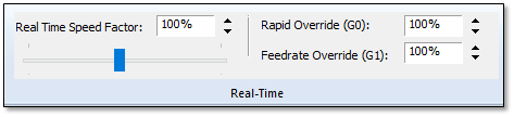

  3. The Real-Time playback section controls the playback simulation speed:
    Real Time Speed Factor – Controls the speed so you can slow down or speed up the simulation. The slider and the arrow buttons allow you to increase or decrease the speed, or you can type the desired percentage directly into the edit box. A value of 100% means that the simulation reflects the feed rate on the machine as accurately as possible. Increasing the speed beyond 100% makes the simulation behave the same as it would at 100%, only faster (the machine’s feed limits are not enforced).
    Rapid Override (G0) – Override the rapid feed rate exactly like the Rapid Override on a machine.  The machine’s feed limits are enforced during playback.  The maximum value for the Rapid Override is 100%.
    Feedrate Override (G1) – Override the cutting feed rate exactly like the Feed Override on a machine.  The machine’s feed limits are enforced during playback.
  4. The Simulation Options section controls the various items that will be checked during the simulation:
    The Real-Time simulation checking options are:
    Overtravels
    M1 (Op Stop)
    M0 (Prg Stop)
    M30 (End Prg)
