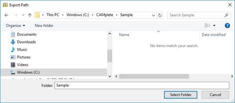

  3. Click Export G-Code to export the G-Code.  You will be prompted for a target folder:
  4. Choose your location and click Select Folder.
  5. The G-Code will be exported to the selected file(s).
  6. Note: If the files already exist, you will be prompted to overwrite them.

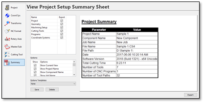

  2. The CAM Wizard will be displayed, showing the Summary page:
  3. The Summary page is described in detail in the CAM Wizard section/
  4. Click Export to save the summary.  You can output the summary to an HTML file that can be loaded into a web browser or spread sheet program.  Or you can output the summary as a PDF with 3D screen shots of major project items.

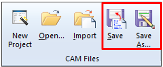

  1. On the Home tab of the Ribbon, click Save or Save As:

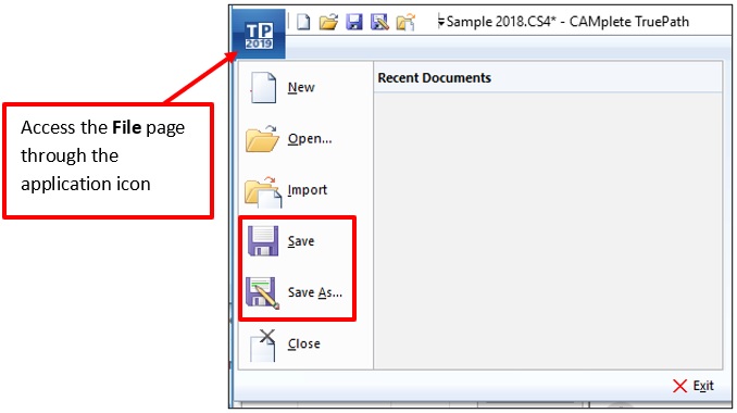

  2. The Save and Save As commands can also be found in the File page of the ribbon.  Click the TP18 icon to access this page:
  3. Click Save to save the document using its current name.
  4. Click Save As to save the document using a new name.
  5. The next time you restart the application, the document will appear under Recent Documents on the Ribbon File page and on the Recent File page of the New Project wizard.
