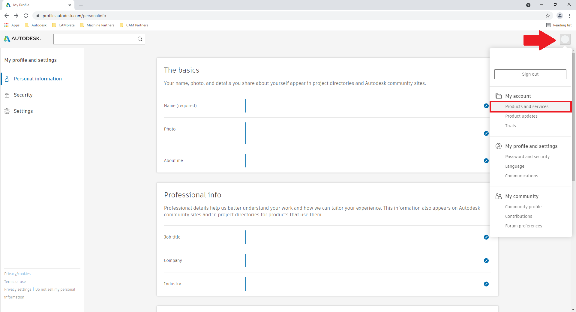

Visit https://accounts.autodesk.com/Authentication/LogOn#username to login to your Autodesk account.
Click on your profile icon in the top/right of the screen and select Products and Services.

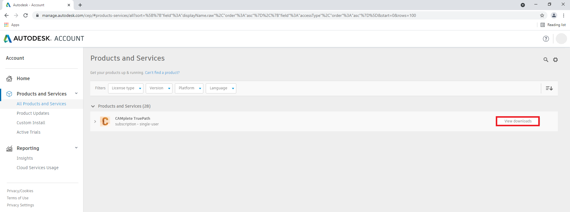

Click View Downloads under CAMplete TruePath.

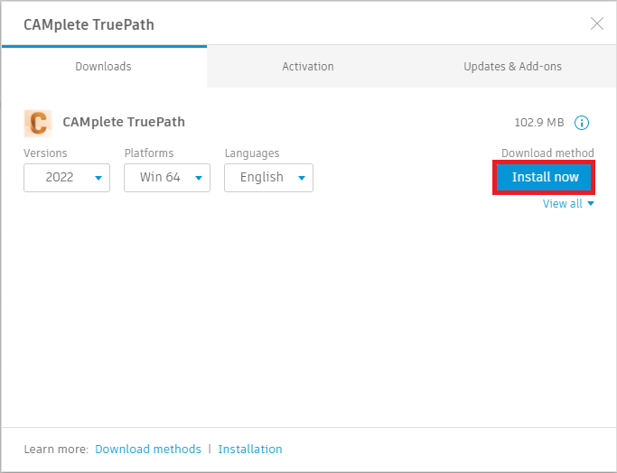

Click “Install Now”.

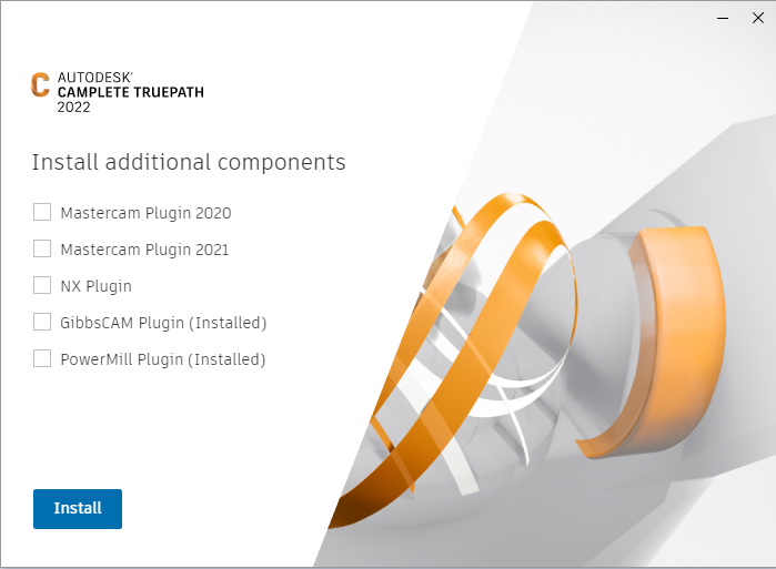

Follow the prompts to install the software. When installing the software, you will be prompted to install CAM system plugins. If a plugin is available for your CAM system, you can select it during the installation process.

If you do not see CAMplete TruePath in your Autodesk account, contact the Autodesk account administrator at your company. The account administrator will need to assign CAMplete TruePath to your Autodesk account. For more information about managing users and software, click here.
