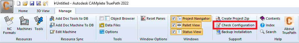

When the machine installer is complete, open Autodesk CAMplete TruePath.
In the ribbon, go to Manage > Support > Check Configuration.

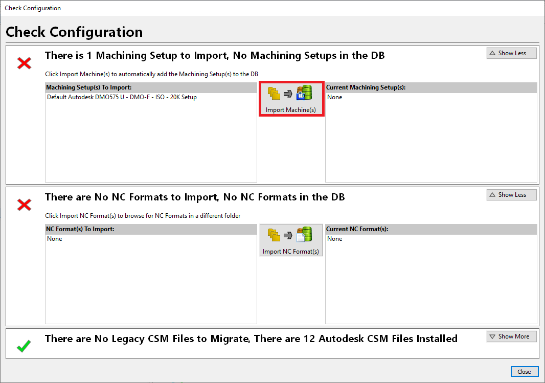

Click Import Machines.
Once the machine moves to Current Machining Setup(s), click Close.
