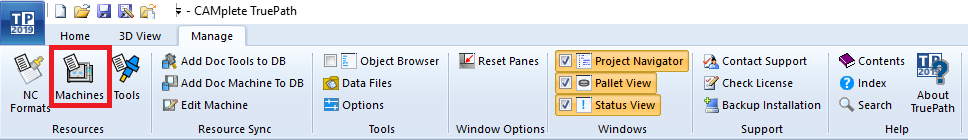

Start TruePath.
In the ribbon, go to Manage > Resources > Machines.

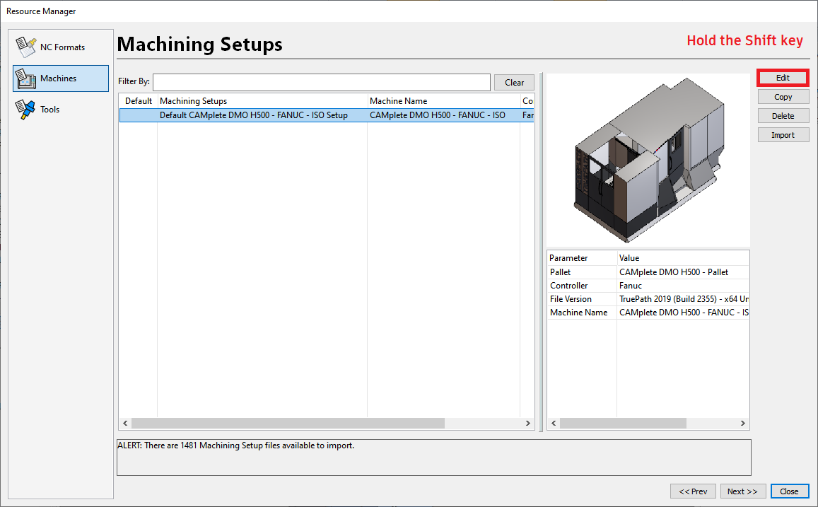

Select your machine.
Click Edit.

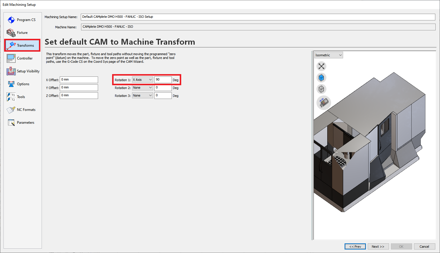

Click Transforms.
Set the Rotation 1 drop down to X axis and set the value to 90.
Click OK.
Click Close.
Next time you create a project with the edited machine a 90 degree transform will be applied to the project automatically.
