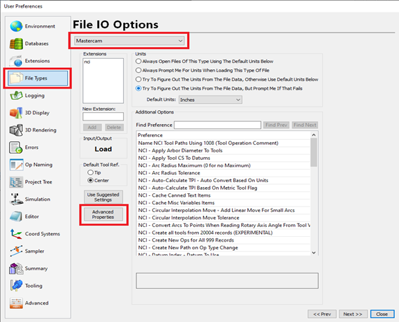

  1. Start TruePath.
  2. In the ribbon, select Manage tab > Options.
  3. Click File Types.
  4. Change the filter to Mastercam from the drop-down menu.
  5. Click Advanced Properties.

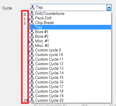

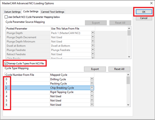

  6. Click Cycle Settings and verify that the order of the cycle mapping matches what you have in Mastercam.
    Note: The cycles in Mastercam start at 0 for Drill/Counterbore and go up by one until 19 which maps to Custom Cycle 20.
    If the cycle list is different, make sure that the order is the same in TruePath as well.
  7. Click OK and close the User Preferences window.
  8. Close TruePath.
Restart TruePath and create a new project to see the changes.
