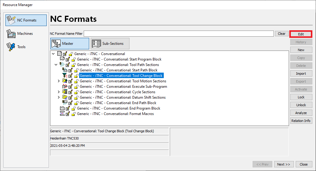

In the ribbon, go to Manage > Resources > NC Formats.
Expand the NC Format to the Tool Change Block.
Select the Tool Change Block and click Edit.

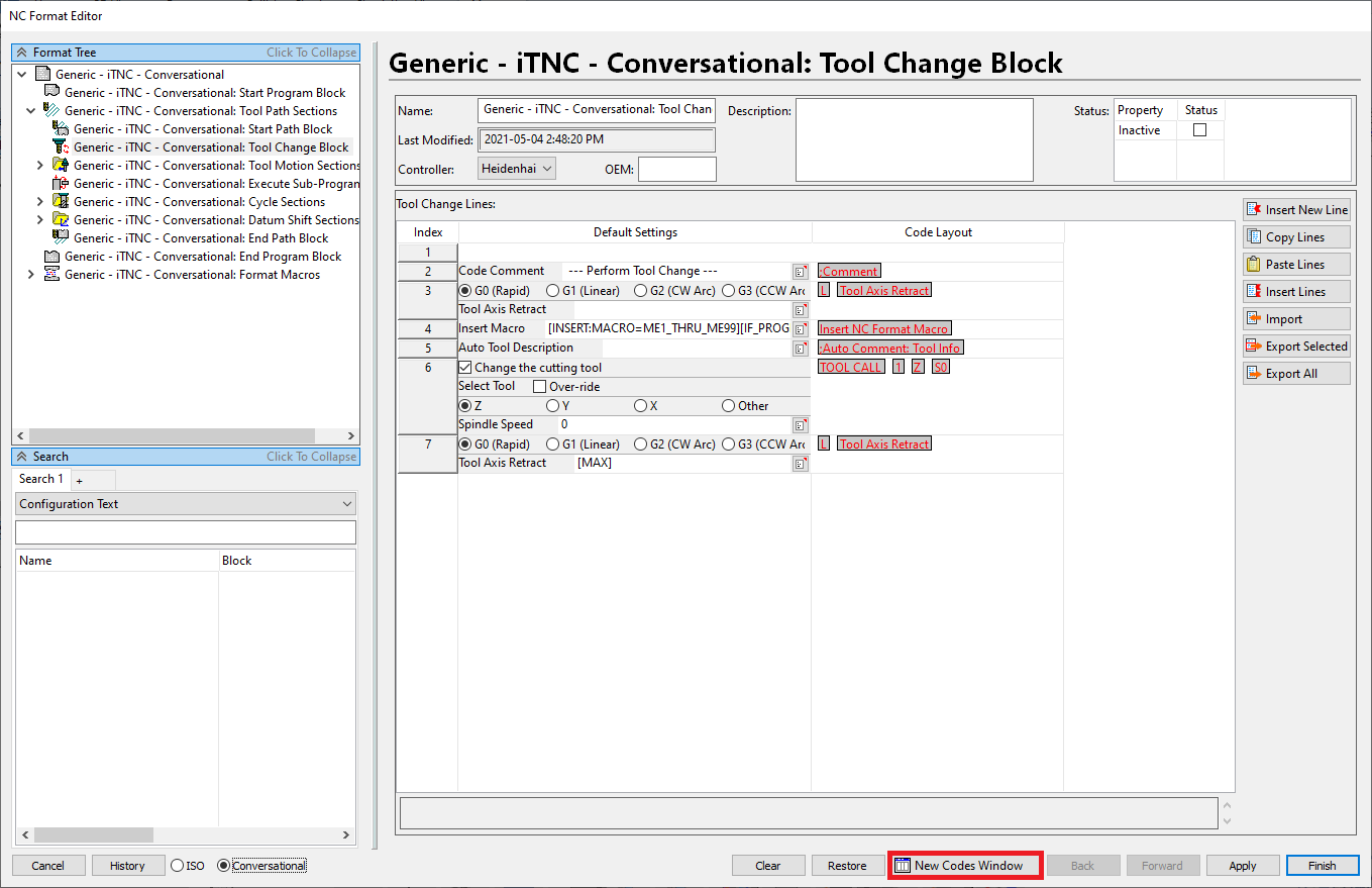

Click New Codes Window.

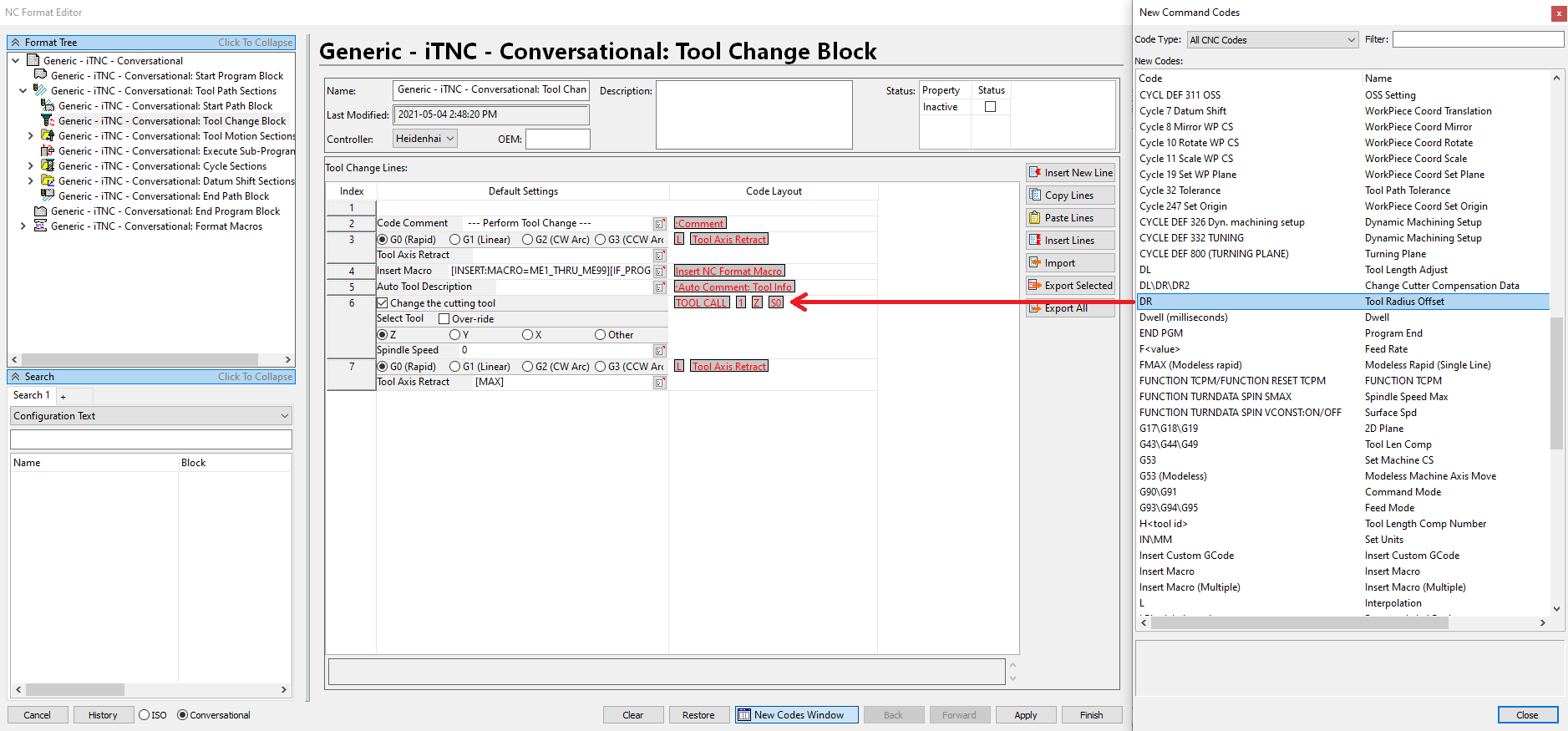

Drag and drop the DR command into the Code Layout column of the TOOL CALL line.
