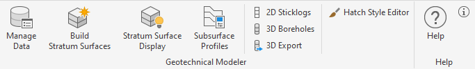

To access the Geotechnical Modeler dialog boxes, do the following:
From the ribbon, select the Geotechnical Modeler tab, then select the appropriate Geotechnical Modeler interface to open:

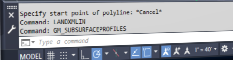

You may choose to enter the command prefix GM from the command line as an alternate method to access the Geotechnical Modeler dialog boxes. The following commands are available from the command line to access the Geotechnical Modeler dialog boxes:
- GM_ManageData
- GM_BuildSurfaces
- GM_StratumSurfaceDisplay
- GM_SubsurfaceProfiles
- GM_Help
