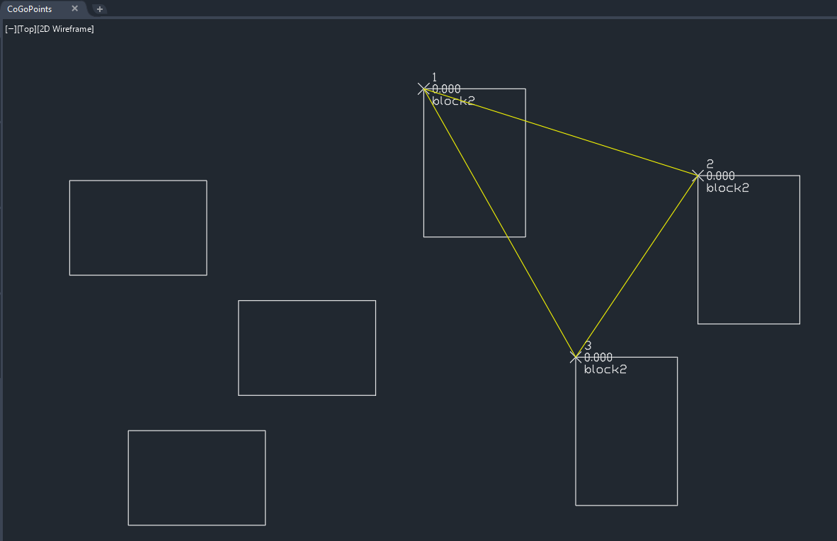

  5. Run Civil 3D and open CoGoPoints.dwg.
  6. Click Manage tab  Visual Programming panel  Dynamo  .
  7. Select File Import Library and select the CoGoPoints.dll.
  8. Open and run the CoGoPoints.dyn graph.
    COGO points are created in the drawing and added to a point group, and a surface is created from the point group.

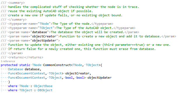

Using Trace Method (CommonConstruct)
The CommonConstruct function is created in both Autodesk.AutoCAD.DynamoNodes.ObjectBase and Autodesk.AutoCAD.DynamoNodes.Object.
Autodesk.AutoCAD.DynamoNodes.ObjectBase Autodesk.AutoCAD.DynamoNodes.Object
You can create classes to inherit either Autodesk.AutoCAD.DynamoNodes.ObjectBase or Autodesk.AutoCAD.DynamoNodes.Object. The methods above can be called when you create new nodes according to the inherited relationship. For example, notice the following node PointGroup.CreateFromPoints.

The CreateFromPoints node can now be defined in PointGroup. Because of the inherent relationship, CommonConstruct in Autodesk.AutoCAD.DynamoNodes.ObjectBase can be called.
The TNode method is the type of the node and required to inherit Autodesk.AutoCAD.DynamoNodes.ObjectBase.
In this example:
TNode = CogoPoints.PointGroup
TObject is the type of the AutoCAD object required to inherit Autodesk.AutoCAD.DatabaseServices.DBObject.
In this example:
TObject = Autodesk.Civil.DatabaseServices.PointGroup
The objectCreator function creates an object. In this example it is defined as the creation of a new point group.
The objectUpdater function updates an object. In this example it is defined as the update of an existing point group.
The CommonConstruct function tries to find existing objects from the traced handle. When found, it updates with the call objectUpdater with isExisting==true. If updating fails, objectCreator calls to create a new object and then the objectUpdater calls isExisting==false.
The CommonConstruct function tries to update existing objects in the database with the same traced handle value. If that fails, it will create a new object. If your object does not support updates you can return isExisting==false. This means you will creating a new object and delete the old object. CommonConstruct will still try to maintain the same handle value in this case.
The complete sample codes are displayed in PointGroup.cs and the CommonConstruct method in Autodesk.AutoCAD.DynamoNodes.Object is as described above.
