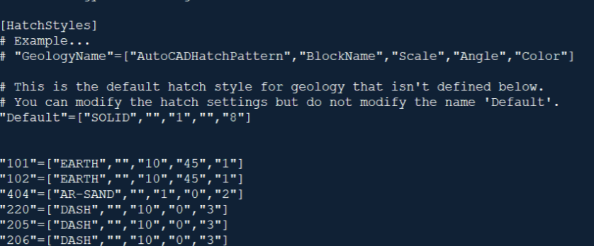

  5. Each line of the file represents a geology type and the parameters required to define the hatch pattern. A portion of the default hatch pattern configuration file appears below:
hatch
Each line of the file must contain a text string for the geology code. This code will match up with the AGS standard or custom geology types included in your dataset.
  • All parameters other than geology name are optional, however they must exist in the following order: GeologyName, HatchPattern, BlockName, Scale, Angle, Color.
** Example:** "GeologyName"=["AutoCADHatchPattern","BlockName","Scale","Angle","Color"]
