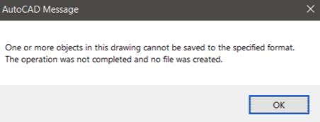

  • There are times that the you may receive the following message, which will prevent you from saving the current drawing:
    knownissues
    • This typically occurs after you have created Subsurface Profiles for the first time within the drawing.
    • To resolve the issue, type the AUDIT command, and select Yes to repair any issues encountered during the audit process.
