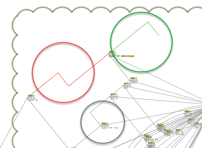

Differences between the comparison drawing and the current drawing are grouped by proximity into change sets that are surrounded by revision clouds. Revision clouds are used on the comparison drawing to highlight the differences between the compared files Color coding is used to identify differences between the drawings.
DWG Compare Color-Code System
Differences in the compared drawings are marked using a color coded system:
  • Red. Objects that are only in the compared drawing.
  • Green. Objects that are only in the current drawing.
  • Gray. Objects that are common to both drawings.

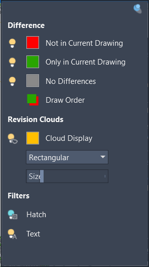

The DWG Compare toolbars provide several commands and options to review and control the comparison result. These commands include the ability to toggle the comparison, import objects, export snapshots of the comparison drawing, and zoom in to the differences between the drawings.
Toolbar 1
toolbar
Command Result
Difference Click the light bulb next to the Not in Current Drawing or Only in Current Drawing options to toggle the visibility of the differences between the compared or the current drawing files.
Draw Order Reverses the draw order between overlapping objects in the current drawing and the compared drawing.
Cloud Display To toggle the visibility of the revision clouds, click the light bulb icon. To change the shape of the revision clouds, select Rectangular or Polygonal from the Revision Clouds drop-down list. To change the offset distance between the change sets and the revision clouds, use the Size slider.The size of the change sets is determined by the proximity of the changed objects compared to the size of the revision clouds.
