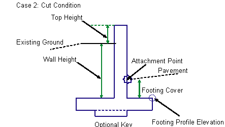

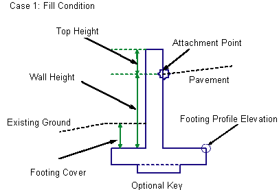

This subassembly inserts a retaining wall structure with both sides as vertical walls (no tapered side), and an optional key at the bottom.
The attachment point varies depending on whether the retaining wall is in cut condition or fill. If it is in fill, the attachment point is near top of the retaining wall. If it is in cut, the attachment point is near the footing.

Wall height is determined from top of the footing to attachment point of ground elevation on the vertical face, whichever is higher. Width of the footing, offset of wall vertical face, optional key dimensions, and the location of the key center, are all functions of the wall height.

This subassembly can be inserted on either the left or the right sides. The attachment point is different for the fill or cut condition. In fill, the attachment point is assumed to be where the finish grade intersects the inside face of the wall, below the top of the wall, at a distance equal to the Top Height parameter. In cut, the attachment point is assumed to be where the finish grade intersects the inside face, above the top-of-footing at a distance equal to the Footing Cover parameter. The wall height is determined from the Wall Height or Profile input.
In fill, the sloping wall face is toward the center of the roadway. In cut, the sloping wall face is away from the roadway, towards the earth being retained. If the Key option is set to No, then the base of the footing is a single horizontal link. If the Key option is used, links to define the optional key are inserted.

Coding Diagram
Fill Condition
Cut Condition
