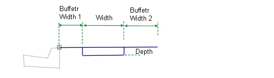

This subassembly is used to insert links defining a concrete sidewalk with optional boulevards.

The attachment point is at the inside edge of the inside buffer.

Width
Width of the concrete sidewalk
Numeric, positive
1.8 m
6.0 ft
Depth
Depth of the concrete sidewalk
Numeric, positive
0.1 m
0.333 ft
Buffer Width 1
Width of the inside buffer zone
Numeric, positive
0 ft, m
Buffer Width 2
Width of the outside buffer zone
Numeric, positive
0 ft, m

The links for the inside buffer zone, sidewalk, and outside buffer zone are inserted outward from the attachment point at a horizontal slope. The buffer zones may be omitted by setting their widths to zero.

In layout mode, this subassembly draws the buffer zone and sidewalk as specified by the input parameters.

P2
Sidewalk_In
Inside edge of sidewalk on finish grade
P3
Sidewalk_Out
Outside edge of sidewalk on finish grade
L1
Top
Datum
L2
Top
Sidewalk
Sidewalk structure top links
L3
Top
Datum
L4 - L6
Sidewalk
Datum
S1
Sidewalk
Sidewalk concrete area
