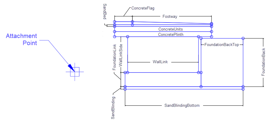

The RailPlatform subassembly includes common layers for rail platform such as walls, concrete plinth, footway, sand bed, foundation, and so on.

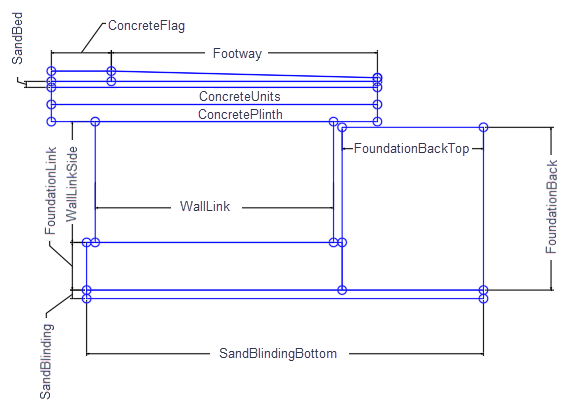

Behavior
This subassembly provides a rail platform that attaches to a rail alignment. Place the platform subassembly insertion point on the centerline alignment and profile of the rail and adjust the behavior by setting the input parameters and optional target parameters listed above.
Layout Mode Operation
In layout mode, this subassembly draws the rail platform.
Point, Link, and Shape Codes
The following table lists the point, link, and shape codes for this subassembly that have codes assigned to them. Point, link, or shape codes for this subassembly that do not have codes assigned are not included in this table.

Coding Diagrams
