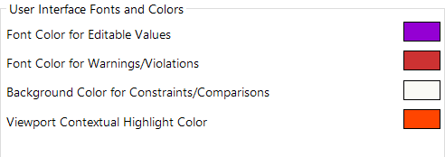

User interface fonts and colors
Font color for editable values
Determines the text color for data columns containing values which can be double-clicked to directly edit the corresponding value in Civil 3D.
Font color for warnings/violations
Determines the text color of any values which are highlighted in the Project Explorer window as violations.
Background color for constraints/comparisons
Determines the background color for data columns which display values from compared or target objects. Compared objects include pipe run comparison surfaces and compared alignments.
Viewport contextual highlight color
Determines the line color for temporarily highlighted points, triangles, or cells in the AutoCAD Viewport when the CTRL button is clicked Project Explorer.

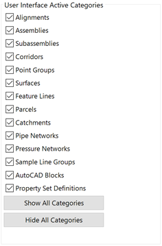

User interface active categories
When undertaking certain tasks in Project Explorer, it is sometimes preferable to disable or hide any Civil 3D Object Categories from the Project Explorer window which are not in use.
These controls allow the visibility of each primary Object Category tab in the Project Explorer window to be set.
