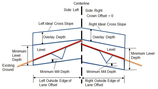

This subassembly adds an overlay layer to an existing crowned roadway, with either a leveling and milling layer added as required.

Left Ideal Cross Slope Specifies user defined left ideal cross slope. User defined, numeric -2.00%
Left Minimum Level Depth The minimum level depth between the bottom of the milling layer to the bottom of the overlay layer on the left side. Numeric, positive 0.600m
Left Minimum Mill Depth The minimum mill depth from the bottom of the milling layer to the bottom of the existing ground layer on the left side. Numeric, positive 0.300m
Left Slope Tolerance Tolerance for varying the left overlay slope. Numeric, positive 0.50%
Right Overlay Slope Options Specifies right overlay slope options. User defined User Defined Without Flapping
Right Ideal Cross Slope Specifies user defined right ideal cross slope. Numeric -2.00%
Right Minimum Level Depth The minimum level depth between the bottom of the milling layer to the bottom of the overlay layer on the right side. Numeric, positive. 0.600m
Right Minimum Mill Depth The minimum mill depth from the bottom of the milling layer to the bottom of the existing ground layer on the right side. Numeric, positive 0.300m
Right Slope Tolerance Tolerance for varying the right overlay slope. Numeric, positive 0.50%
Left Lane Width The left lane width, determined by the offset of the outside edge of the left lane from the inside edge of left lane. Numeric, negative. -12.000m
Right Lane Width The right lane width, determined by the offset of the outside edge of the right lane from the inside edge of right lane. Numeric, positive. 12.000m

Behavior
This overlay layer assumes that flapping is applied within slope tolerance. Elevation at the crown will meet both sides of the roadway.

Coding Diagram
