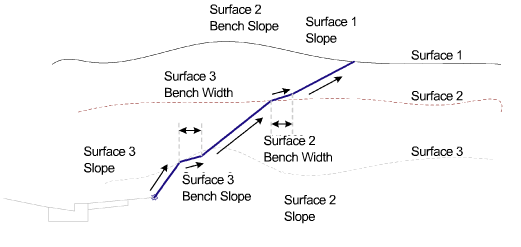

Behavior
In a fill situation, a daylight link is inserted with a slope based on the fill slope input parameter to surface 1. In cut, the subassembly first checks to determine if it is below surface 3 by applying the surface 3 slope, and checking for intersection. This process repeats for each additional surface. Optionally, between the surfaces optional transitions can be added at the surface changes. The bench width and slope for the surface that was just intersected will be used.

Coding Diagram
