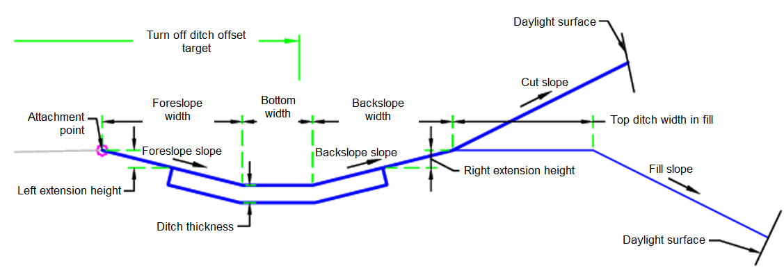

The SideSlopeCutDitch subassembly inserts links to create an optional ditch and then daylights to cut and fill.
The attachment point is at the inside edge of the initial cut or fill slope. This component can be attached to either the left or right side.

Behavior
The initial hinge point is set at the attachment point. The hinge point elevation is checked against the target surface to determine if the section is in the cut or fill condition.
If the parameters require a ditch, the ditch is built using the input parameters. If the Omit Ditch target is found, then the ditch will not be built. The ditch lining, if the ditch thickness is greater than 0, is built. If the ditch is in fill, the top ditch width in fill is applied.
The ditch hinge point is checked against the target surface to determine if the section is in the cut or fill condition. Then the daylight link is created using the appropriate Fill Slope and Cut Slope.
If no ditch is required, the daylight link is created using the appropriate Fill Slope and Cut Slope.
