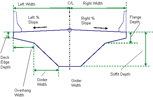

Left Width |
Width of the left side of the bridge deck |
Numeric, positive |
5.34 m 17.8 ft |
Right Width |
Width of the right side of the bridge deck |
Numeric, positive |
5.34 m 17.8 ft |
Left - Use Superelevation |
Specifies to use superelevation slope on the left side of the bridge. |
List of options: No, Inside Lane Slope, Outside Lane Slope |
Default Left Slope |
Specifies default slope for the left side of the bridge, if superelevation slope is not specified. |
Numeric |
-2.0% |
Right - Use Superelevation |
Specifies to use superelevation slope on the right side of the bridge. |
Default Right Slope |
Specifies default slope for the right side of the bridge, if superelevation slope is not specified. |
Numeric |
-2.0% |
Soffit Depth |
Vertical distance from the edge of bridge deck to the soffit |
Numeric, positive |
2.0 m 6.67 ft |
Edge Depth |
Thickness of the bridge deck at the edge |
Numeric, positive |
0.150 m 0.5 ft |
Flange Depth |
Vertical distance from the edge of bridge deck to the root of the flange |
Numeric, positive |
0.300 m 1.0 ft |
Overhang Width |
Width of the overhang |
Numeric, positive |
1.2 m 4.0 ft |
Girder Width |
Width of the girder |
Numeric, positive |
2.0 m 6.67 ft |

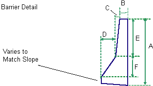

Barrier A (mm or inches) |
Height of the barrier at the center of median |
Numeric, positive |
810 mm 32 in |
Barrier B (mm or inches) |
As shown in diagram |
Numeric, positive |
131 mm 4.5 in |
Barrier C (mm or inches) |
Numeric, positive |
59 mm 2 in |
Barrier D (mm or inches) |
Numeric, positive |
125 mm 5 in |
Barrier E (mm or inches) |
Numeric, positive |
557 mm 22 in |
Barrier F (mm or inches) |
Numeric, positive |
178 mm 7 in |

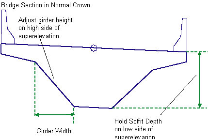

The subassembly builds the links for the bridge deck and under-structure based on the input parameter values given. In superelevation, not all of the structure is rotated. The Soffit Depth is held to the given value from the top-edge-of-deck on the low side of the bridge, and the height of the girder is adjusted on the high side to the root of the deck.
If Include Barriers is True, New Jersey barrier sections are added at the left and right edges-of-deck. The slopes of the barrier bottoms adjust to match the deck slopes.
