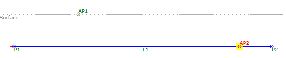

Example
To see an example of how this geometry element is used, open the following Sample PKT file:
Auxiliary Intersection Example.pkt
In this example, the
Auxiliary Intersection (AP2) is created at the intersection of L1 and a specified slope from AP1. The slope is extended and reversed.
