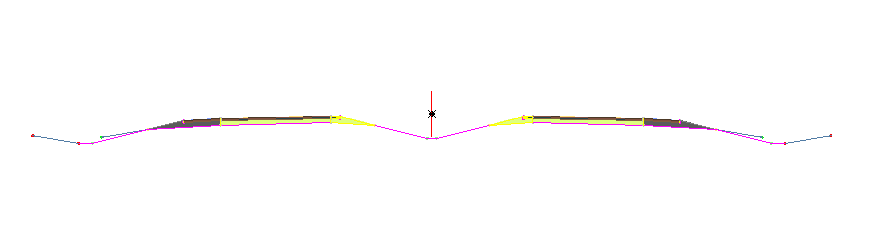

An assembly baseline is typically located in one of two places, as shown in the following figures.
Central Baseline
Figure 2: Assembly for divided roadway
The assembly in figure 2 has a baseline in the center of a ditch between two roadways. This assembly can be used for a corridor designed symmetrically along a single central baseline. However, if you are designing a corridor section from the gutter flow line or another outside line, it usually makes more sense to place your baseline at that location. The best practice is to set your baseline along the primary alignment that controls the corridor’s location.
