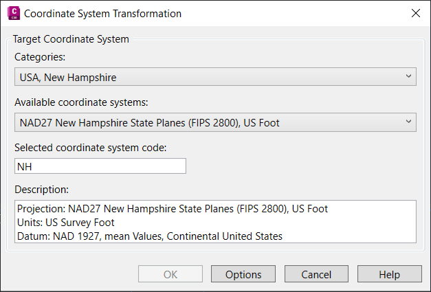

  3. Select the target geographical coordinate category.
  4. Select the target coordinate system.
  5. (Optional) To define how specific types of elements are affected during transformation, click Options to open the Transformation Options dialog box.
  6. Click OK.
  7. In the transformation prompt, click Transform the Model to allow the transformation; or click Cancel to close the transformation tool without making changes.
